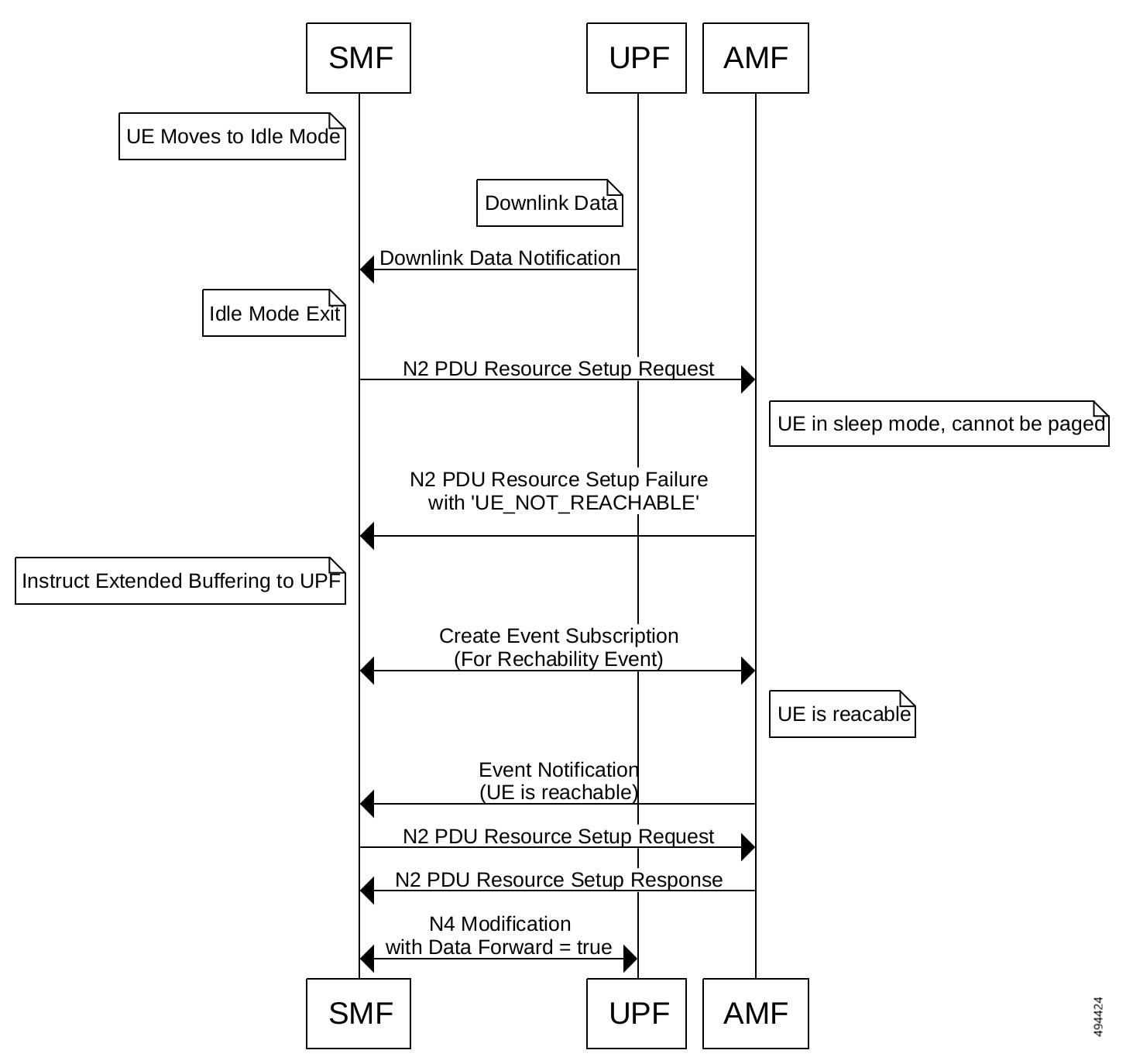

How RedCap Support works
Summary
This process explains the process in which Reduced Capability functionality works.
Workflow
Figure 1. Call flow for PDU Session Establishment for RedCap UEs
Note
For this feature to work
  • HLCOM should be enabled on SMF. For more details on the HLCOM configuration, see the Enable HLCOM for a RedCap session section.
  • The compliance profile should be configured with v17.5.0 for the service nsmf-pdusession.
These stages explain the process of RedCap support on SMF:
  1. RedCap PDU Session Establishment: A RedCap UE sends a PDU Session Establishment Request to AMF.
    Upon receiving the request, AMF sends a PDU Session SM Context Request to SMF and sets the ratType IE as RedCap in the message.
  2. Subscription, policy creation, and charging data requests: SMF receives the ratType IE as RedCap from AMF and forwards it to UDM, PCF, and CHF for subscription, policy creation, and charging data requests respectively.
  3. BAR creation during N4 Session Establishment: The buffering duration and packet count for HLCOM are communicated from the SMF to the UPF using Buffering Action Rules (BARs) as defined in the 3GPP TS 29.244 specification.
    SMF sends the N4 Session Establishment Request to the UPF including the ratType IE as RedCap. SMF also creates an empty BAR and associates it to the FARs during N4 Session Establishment.
  4. UE's entry in the Idle mode: SMF instructs the UPF to buffer when the UE moves to idle state. SMF sends an N4 Session Modification Request to UPF with UpdateBAR IE containing these IEs:
    Table 2. Buffering IEs in UpdateBAR IE
    Buffering IE
    Description
    DDND (Downlink Data Notification Delay)
    The UP function supports the buffering parameter "Downlink Data Notification Delay (DDND)".
    SBPC (Suggested Buffering Packets Count)
    The UP function supports the "Suggested Buffering Packets Count (SBPC)" is present, when the UP function indicates the support of the feature UL/DL Buffering Control (UDBC).
    UPF sends the Downlink Data Notification to SMF.
  5. UE's exit from the Idle mode: SMF sends an N1 N2 Transfer Request to AMF. SMF sets the extBufSupport IE (Extended Buffering Support) to true in the N2 PDU Setup Request message to indicate extended buffering support to AMF based on configuration and based on the UPF support.
    SMF does not set extBufSupport to true in case of paging for a control plane message.
    As the UE is unreachable, the AMF sends a PDUSessionResourceSetupRequestTransfer Response message to SMF including the status code and cause as 504: UE_NOT_REACHABLE. SMF also receives a maxWaitingTime IE (Estimated Maximum Waiting Time) in the N1N2MsgTxfrErrDetail IE. SMF starts the maxWaitingTime IE timer and stores the flow information for retry.
    SMF sends the N4 Modification Request with UpdateBAR with "DL Buffering Duration (DBD)" same as the estimated maximum wait time and "DL Buffering Suggested Packet Count (DBPC)" from the configuration, if the UPF has indicated the support for DBDM.
  6. Subscription to UE reachability Notification: SMF subscribes to AMF's CreateEventSubscriptions, when it receives the error 504: UE_NOT_REACHABLE from the AMF. The subscription includes the event types as REACHABILITY_REPORT and reachability filter as UE_REACHABLE_DL_TRAFFIC, if the configuration is present.
    For more details on the configuration, see the Configure HLCOM RedCap sessions section.
  7. UE reachable: SMF receives the event notification from the AMF, once the UE is reachable again. This notification includes a UE Reachability filter as Reachable.
    SMF extracts the QCI and ARP values from the flow that is marked as awaiting_reachability. When the UE moves to the active state, the status is reset.
    SMF sends the N1N2 Transfer Request containing N2 Setup Request, to AMF.
    AMF sends a N2 Setup Request to the gNB. The gNB sends N2 Setup Response. SMF sends the N4 Modification Request to the UPF.

[smf] smf(config-actiondef-adRedcap)# priority 1 action subscribe-ue-reachability
[smf] smf(config-actiondef-adRedcap)# exit
[smf] smf(config)#
Configure failure handling template for AMF's Event Exposure service
This task allows you to configure the failure handling template for AMF's event exposure service.
Before you begin
Before configuring the failure handling template, you must subscribe to AMF's Event Exposure service. For more information, see the Configure HLCOM RedCap sessions.
Procedure
Step 1
Use the CLI profile nf-client-failure nf-type amf to create an instance of the peer AMF.
Example:
[smf] smf#config
[smf] smf(config)#profile nf-client-failure nf-type amf
[smf] smf(config-amf)#
Step 2
Use the CLI profile failure-handling failure_handling_profile to create a failure handling profile for AMF.
Example:
[smf] smf(config-amf)#profile failure-handling FHAMF
[smf] smf(config-failure-handling-FHAMF)#service name type namf-evts
Step 3
Use the CLI message type message-type to configure the message type in the event of the failure.
Example:
[smf] smf(config-failure-handling-FHAMF)#message type AmfCreateEvtSubscription
Step 4
Configure status code, retry, and action for handling failure.
Example:
[smf] smf(config-failure-handling-FHAMF)#status-code httpv2 504
[smf] smf(config-failure-handling-FHAMF)#retry 1
[smf] smf(config-failure-handling-FHAMF)#action retry-and-continue
